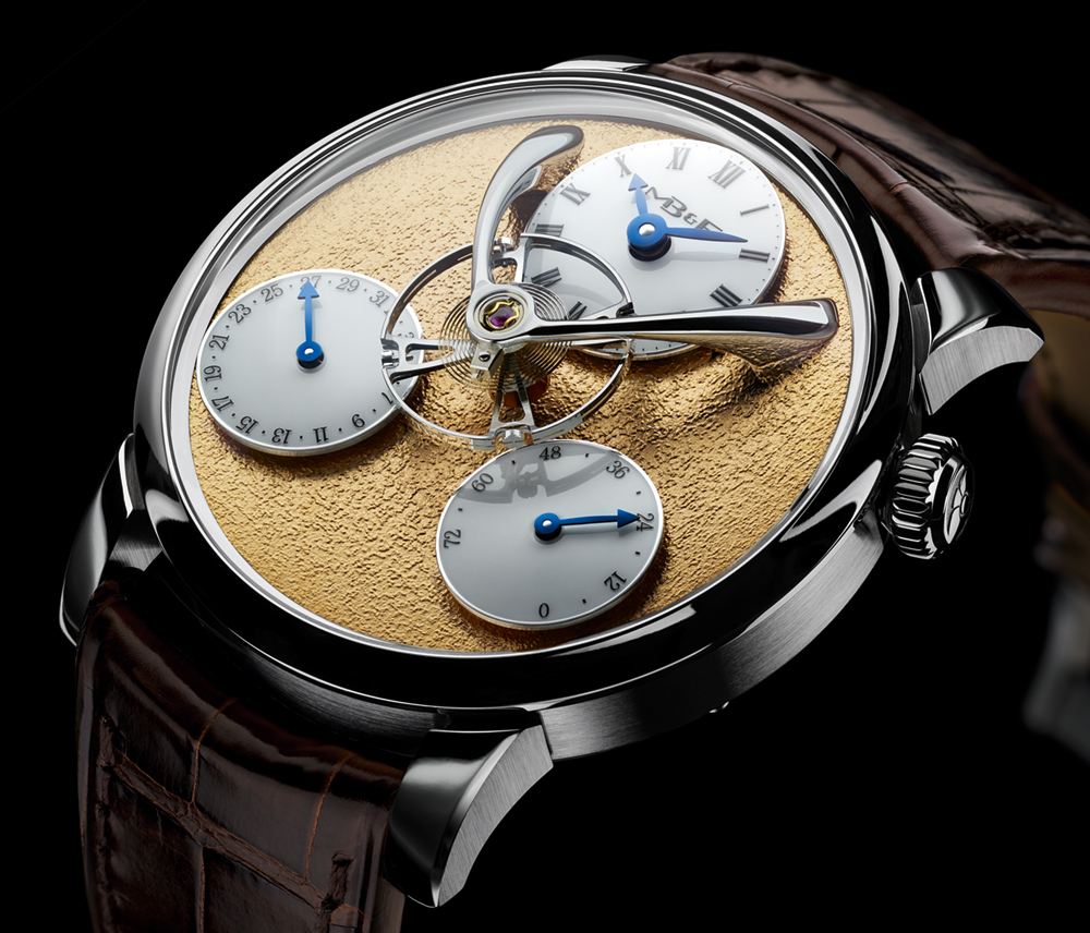

Post by sistem_32 »
Speaking of MB&F and escapements, their Legacy Machine Split Escapement presents an interesting novelty. Its balance wheel is placed above the dial, as usual for MB&F, but the rest of the escapement (i.e. the pallet fork and escape wheel) is all the way on the other side of the movement. This creates a very clean, elegant visual effect. They also used it in their LM Perpetual.
It's also a greater technical challenge than you might think. The rod connecting the balance to the rest of the escapement is 12mm in length. MB&f describes their tolerances for the pivots at the ends of this rod this way: if the 12mm rod were a four story building, the pivots would be about 10cm long, and their maximum tolerance would be about 2mm. I can only imagine the production methods used to achieve that level of precision.
Great footage and coverage here.
